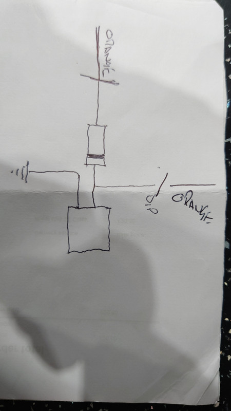

Postby Thackers » Sat Mar 01, 2025 5:58 pm
So, I'm finally getting round to trying to sort my lights :roll: is the attached diagram I've drawn the correct plan to achieve what has been explained in the previous reply? Thanks.
Be kind as I'm no electrician, but willing to have a go and learn a little
The box on the diagram is the capacitor
https://i.postimg.cc/1RNqtYQS/20250301-164157.jpg

Postby Fast n Furious » Sun Mar 02, 2025 12:58 am
Yes.
Just remember to make sure that you connect the capacitor up the correct way around. (-ve of the cap to chassis and +ve to the cut orange wire leading to the dip/beam switch.)

Postby Thackers » Sun Mar 02, 2025 10:22 am
Fast n Furious wrote:Yes.
Brilliant, thank you for your replies and help, I really appreciate your time and advice which I followed and bought one of the bulbs you suggested. 8-) 8-)
