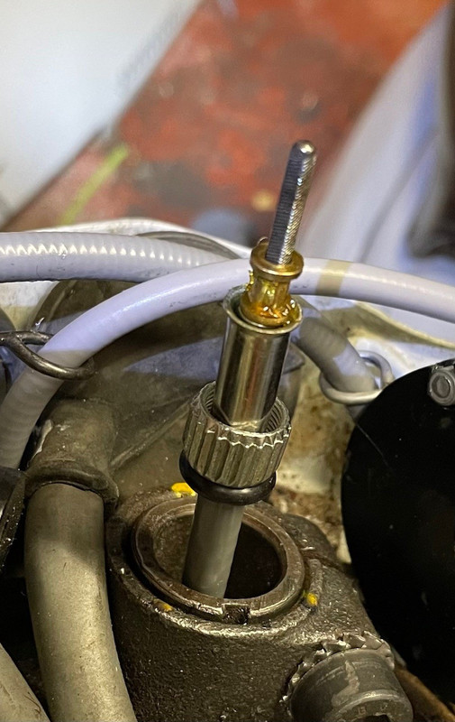

I’d never realised that there were different versions so your post prompted me to go and have a look at some of my spares (used and unused).
The one in the bag is MEC/EUR. I think it predates the pandemic and it is, as you say, a complete pressed in end. The one on the right is a used one and has the shaped cable end. Sadly, I have no recollection as to where this came from.

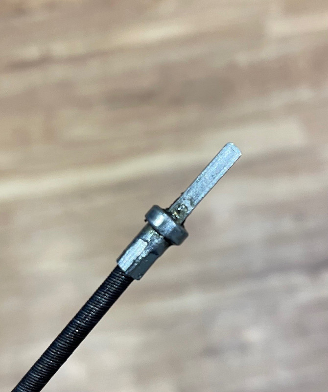

Postby nsaints » Fri Mar 28, 2025 7:38 pm
Here's the new style mec-eur with the alloy drive that drops off the cable. Lasted to the end of the road and mine failed
One to avoid
Instead bought a BGM cable which is much better quality using the traditional square drive machined in the cable, and no alloy drive arrangement to fail in no time at all
