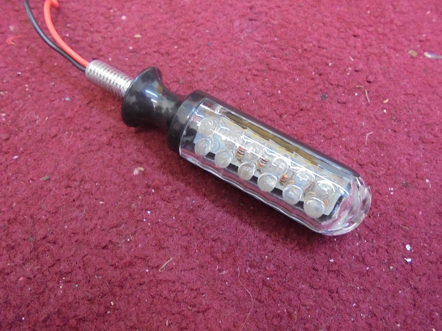

front indicators
rear indicators

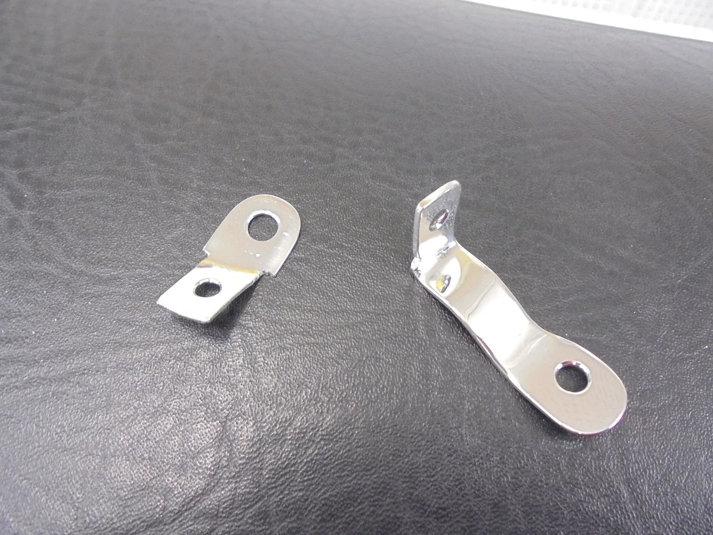

i've had to cut the angled part of the lug off and re-drill it
at this stage i'm keeping hole drilling/welding to a minimum till i'm really happy with things.
stainless switch brackets.

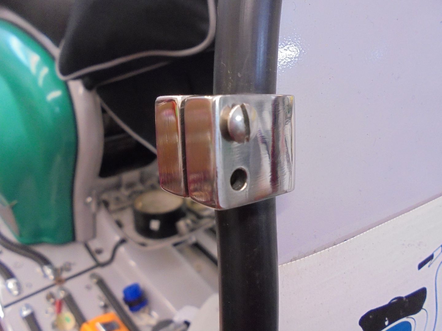

stainless 2 piece clamp
lamp bracket mild steel and mattblacked
wires neatly out of the way

rear indicators are angled up slightly to be in the following driver's eye line, well that's my theory anyway!

i fitted some of these
http://www.amazon.co.uk/gp/product/B00M ... ge_o01_s00
as they looked as if they would blend in trouble is just not bright enough wife following in car in daytime coudnt be sure if they were on or not
buy cheap buy twice strikes again

i agree there are naff ones out there, i returned some that were useless but the ones i have used really work

all indicators and flasher unit came from ebay, indicator switch from AJ Sutton.
front indicator - £6.00
rear indicator - £16
flasher unit - £2 (make sure it's for LED lamps)
