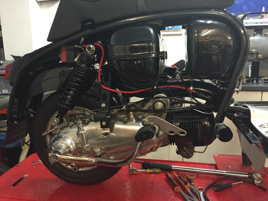

Been doing a little bit tonight!

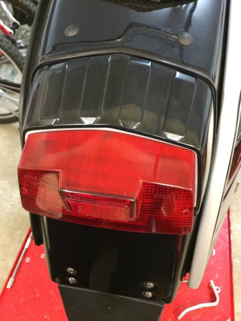

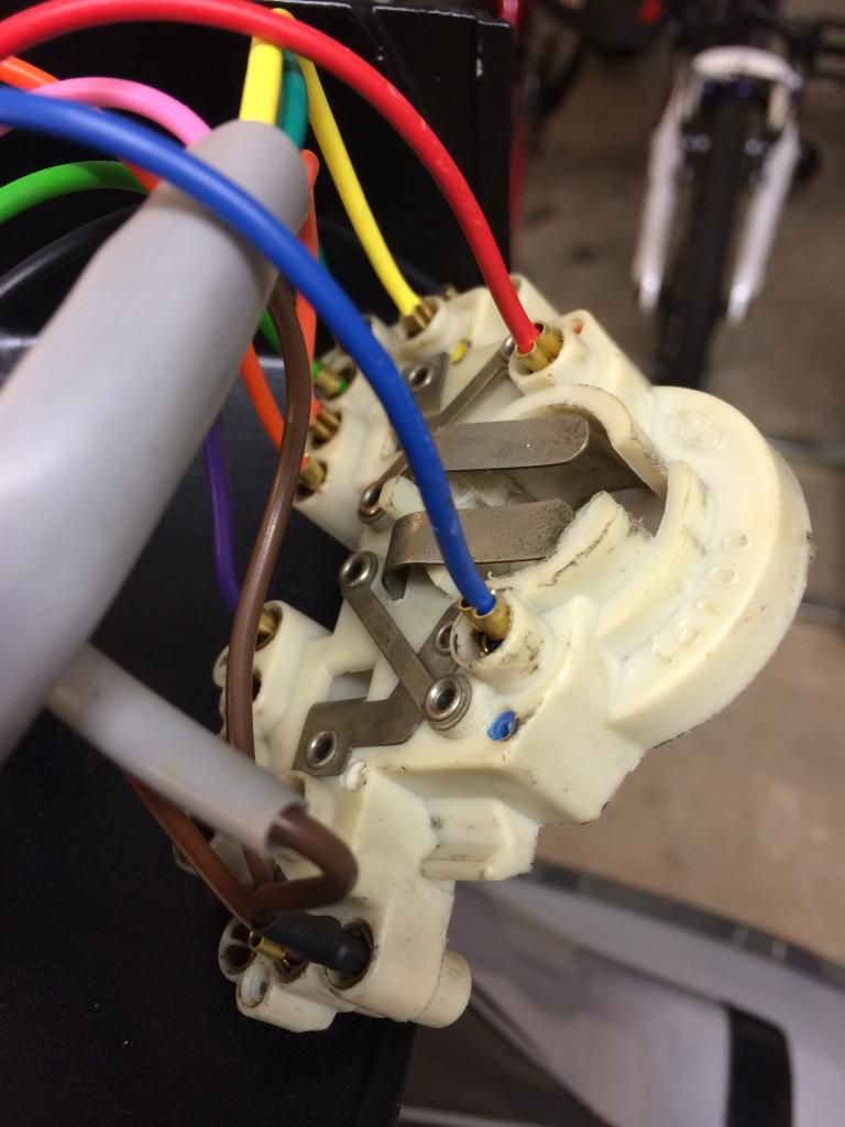

Fitted an original CEV wiring connector.
Added an inline choke cable adjusted.

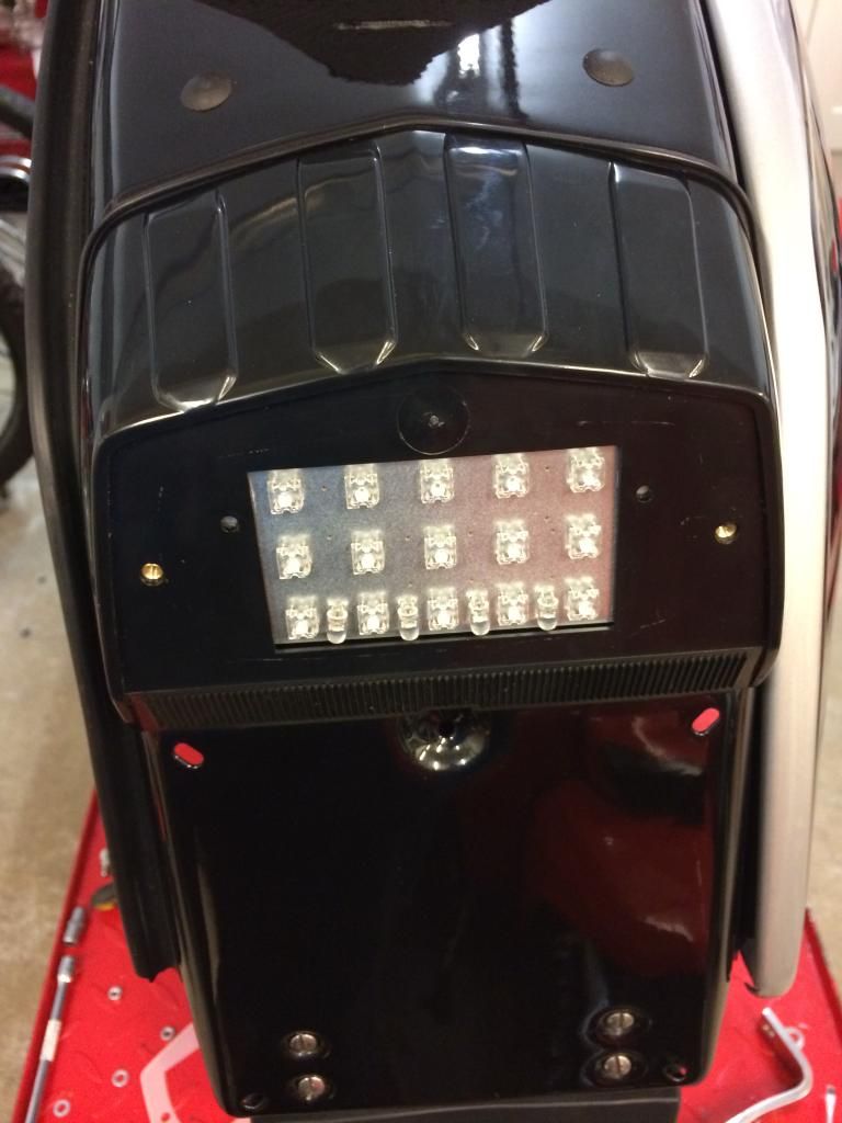

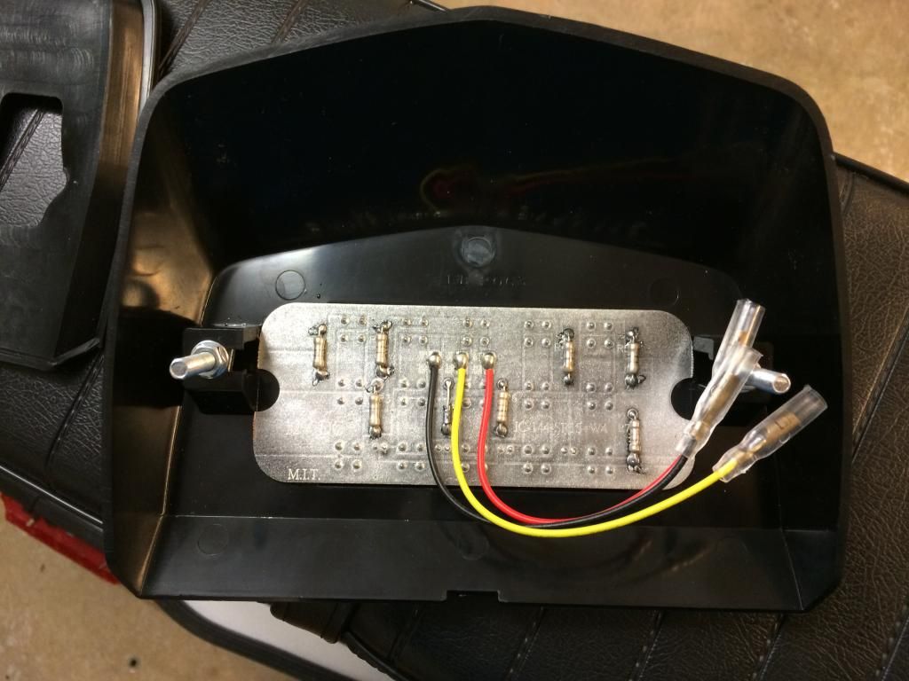

Made an LED rear light from a Bossata pattern GP light and a BGM LED rear light board.
That's all folks.

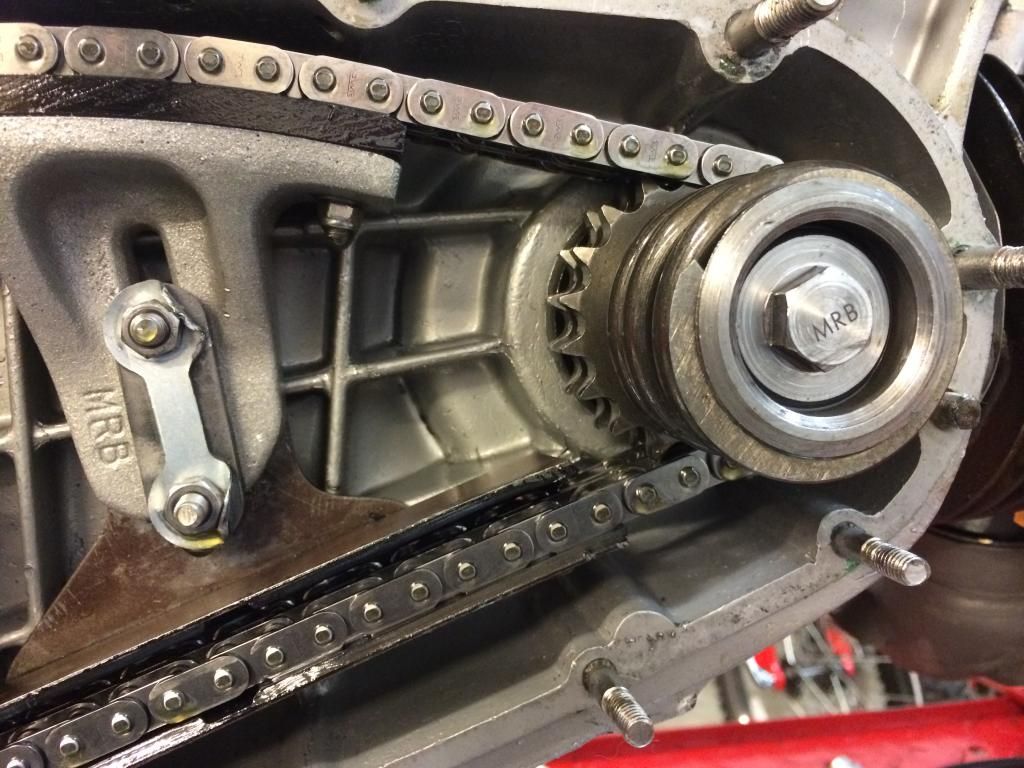

Postby Kirk St Moritz » Wed Nov 26, 2014 10:51 pm

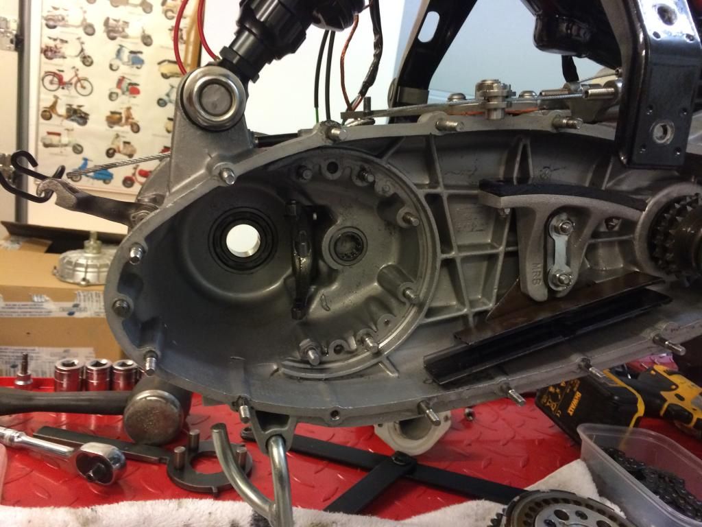

So I was about to fit the gearbox, but went to the pub instead!
So eventually got round to it........

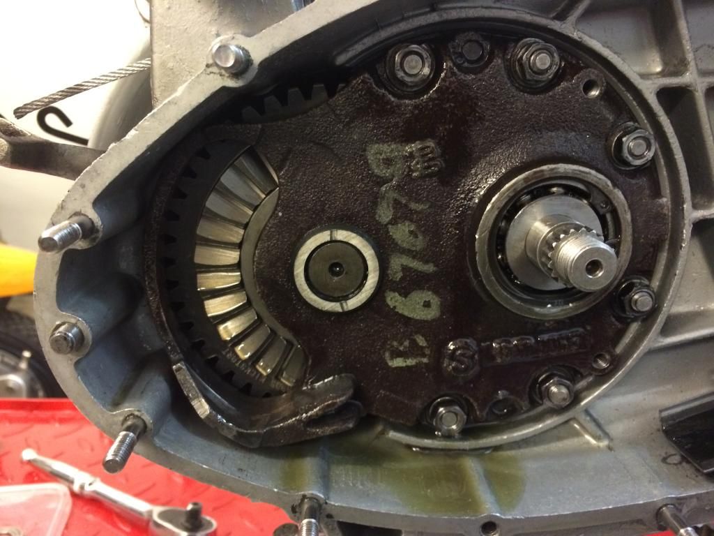

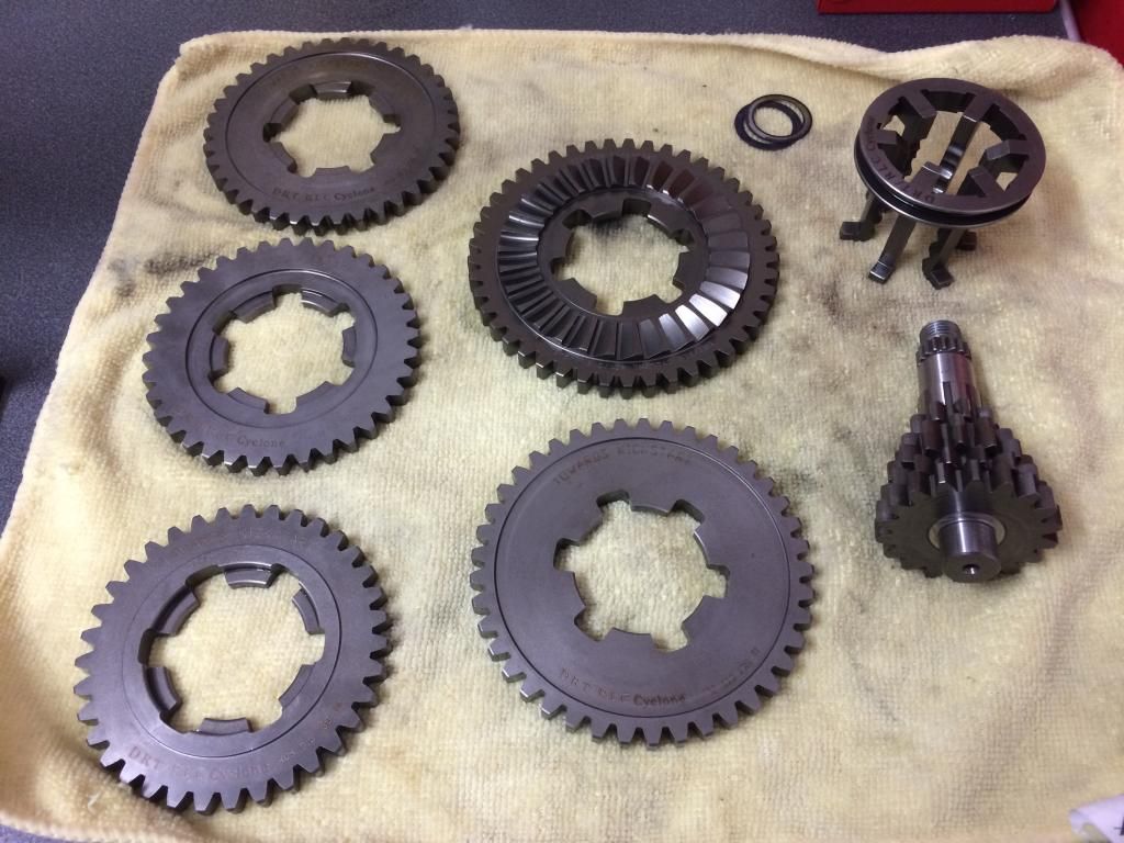

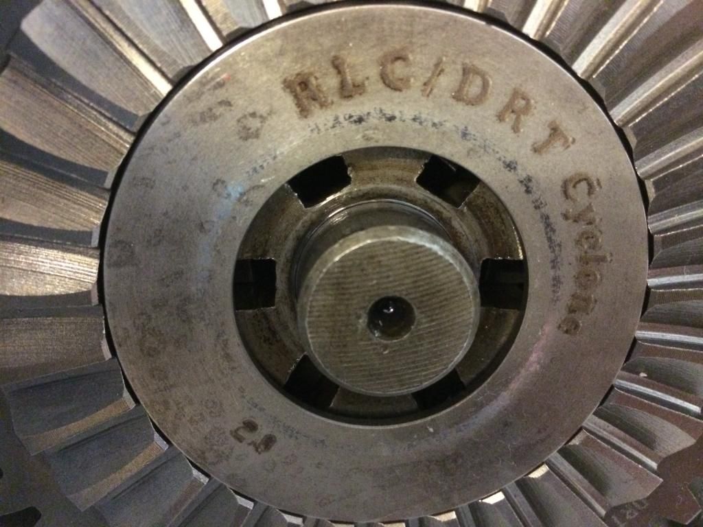

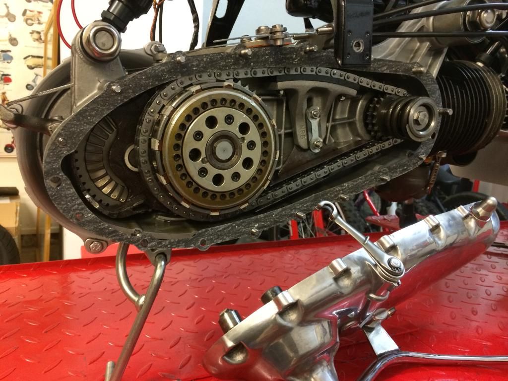

Used MB parts
And AF cassette clutch
All stripped

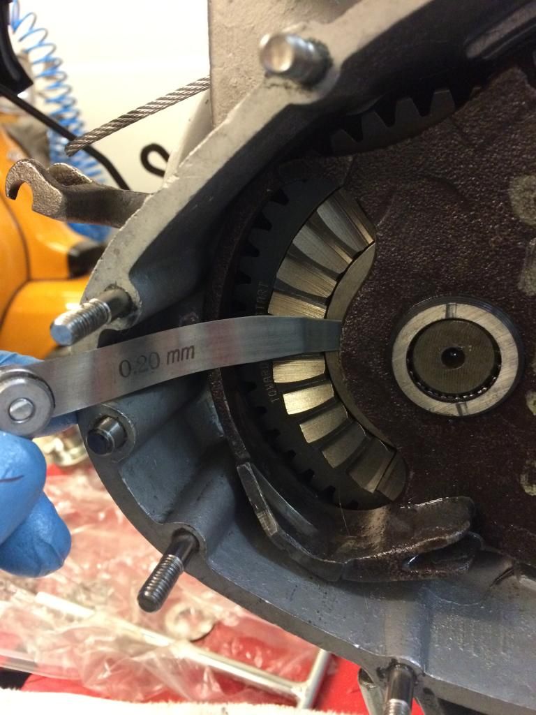

Various large shims were tried
Shimmed up with a 0.2 mm clearance and a 1.6 mm large shim.

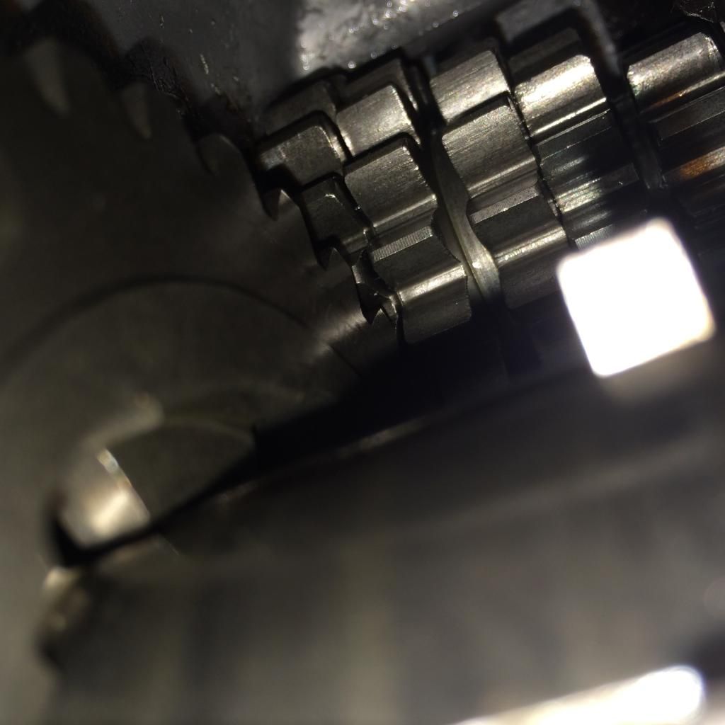

Then checked for fifth gear and cluster alignment.

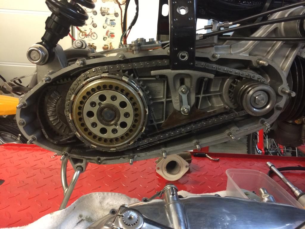

Gearbox assembled
And with chain and clutch fitted!

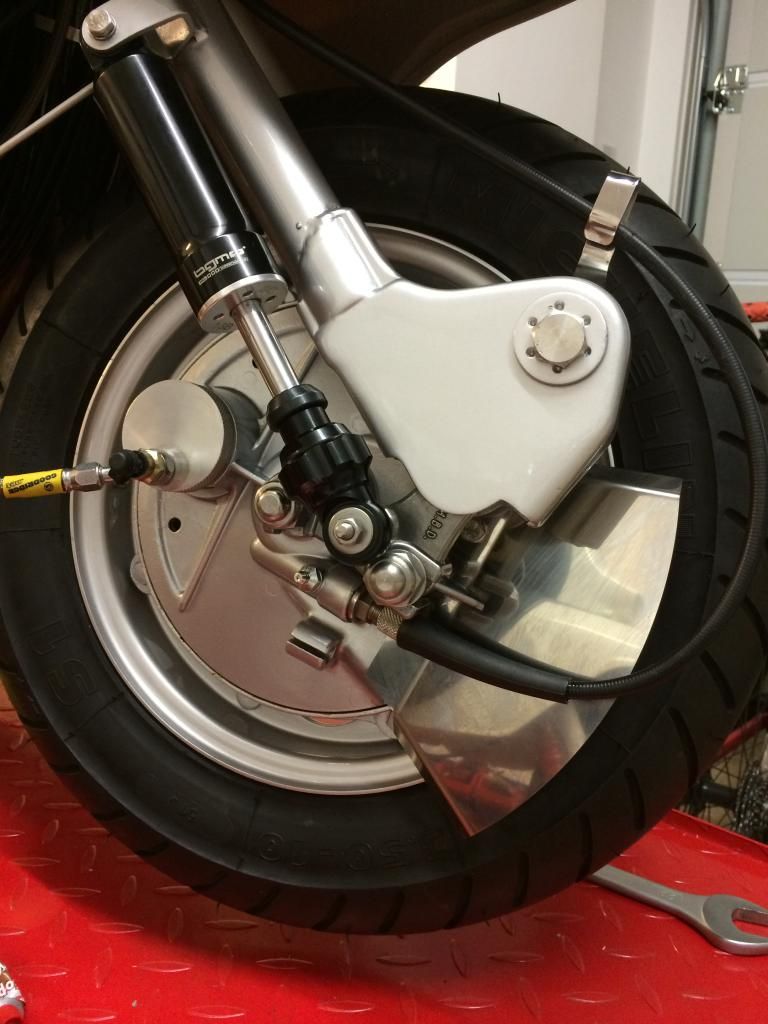

Postby Kirk St Moritz » Sun Nov 30, 2014 8:31 am
Added an air scoop to the front hub, I'm going to mount the reed relay speed sensor from the Gamma Technologies RSTE 1000 unit to it so it moves with the suspension, rather than fixing it at the fork link pivot point.

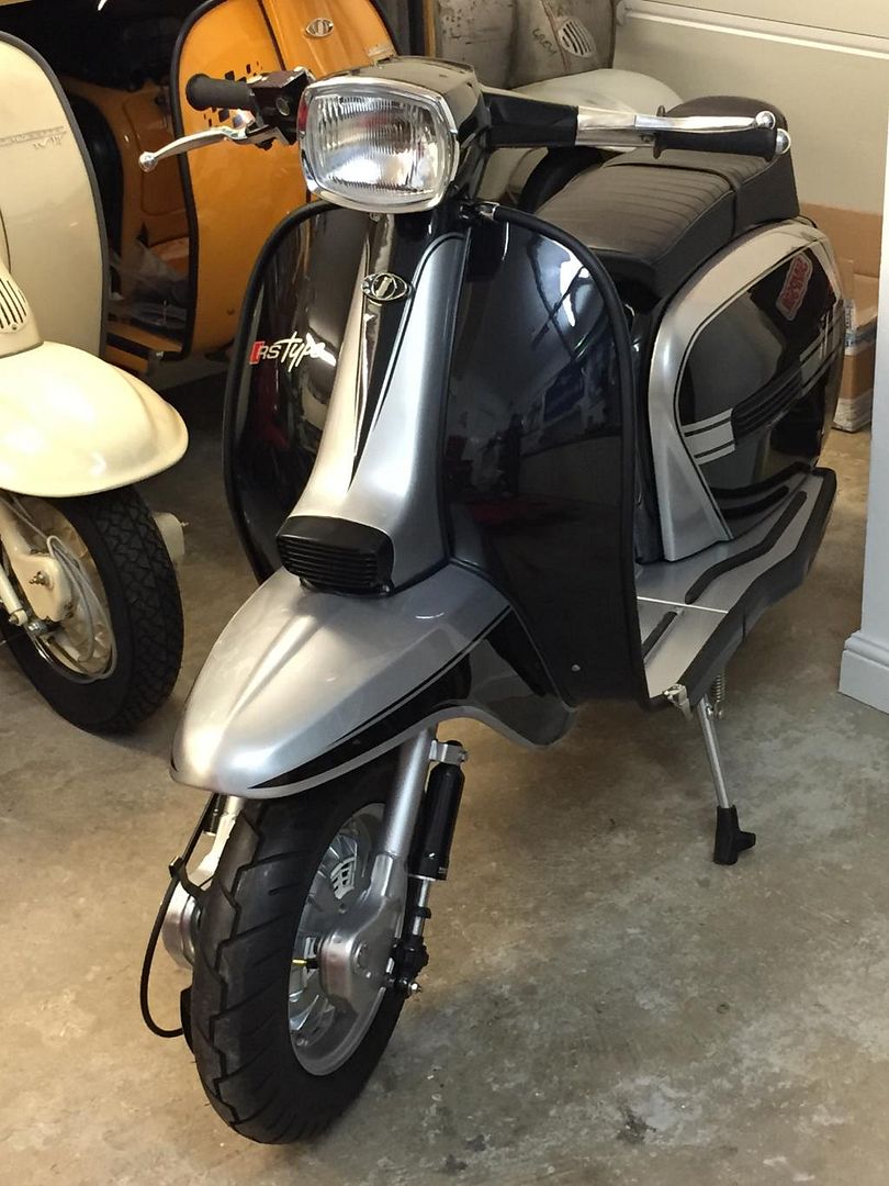

Postby Kirk St Moritz » Wed Jan 21, 2015 2:58 pm
Ta!
So it's been a while since I updated this thread cos I've been waiting for parts, but it's getting there!

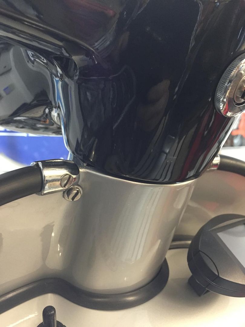

So after I scratched the headset putting the steering lock in I decided to have the innocenti headset welded up to blank off the steering lock! I don't ever rely on it anyway!
Also I chickened out of painting the tanks and other tinware under the panels a bright colour and simply went for basalt Black!
Just a few things to do, such as bleed the front brake, put oil in it, fit the Mtech unit, jet the carb appropriately and get it registered.

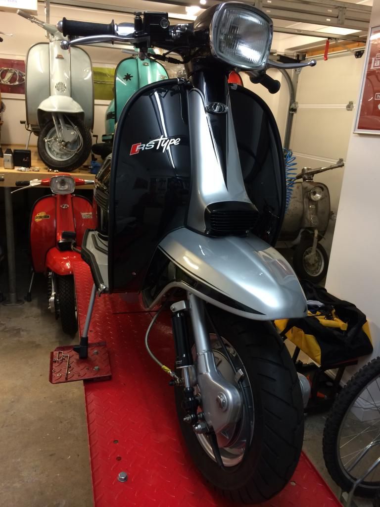

Postby Kirk St Moritz » Sun Feb 01, 2015 9:09 pm
Just need to register it and run it!

Postby Kirk St Moritz » Thu Mar 26, 2015 10:22 pm
Ta.
All registered and ready to go.
