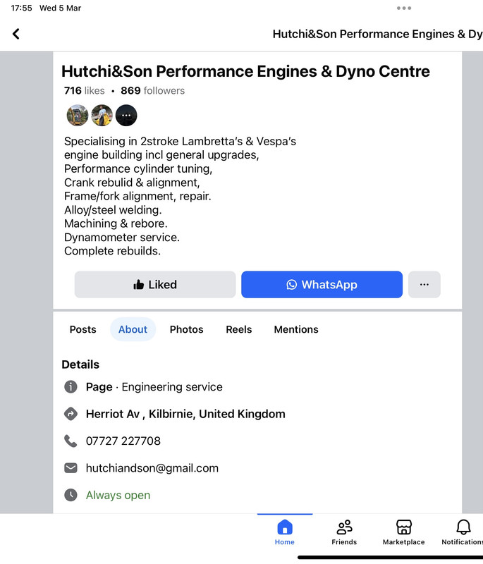

Postby Toddy » Wed Mar 05, 2025 6:59 pm
Is hutchi and son performance anywhere near heard good reports on dynos and tuning
Posts: 10214
Re: VHSH 30mm
Postby B1gD0gu3 » Wed Mar 05, 2025 7:59 pm
I never even knew they existed, thank you very much for that! I will check them out. :D

Postby Toddy » Wed Mar 05, 2025 8:00 pm
B1gD0gu3 wrote:I never even knew they existed, thank you very much for that! I will check them out. :D
No worries, good luck, he has a Facebook page as well if you do social media

Postby B1gD0gu3 » Thu Mar 06, 2025 8:50 pm
Have been in touch with them today, seems very knowledgeable and a genuine person. Am taking the scoot over to get it set up on the dyno. Will post results once i've got it sorted.
Thanks for the replies, appreciated & thank you Toddy for finding the place, 40minutes away & I didn't know it existed! :oops:
