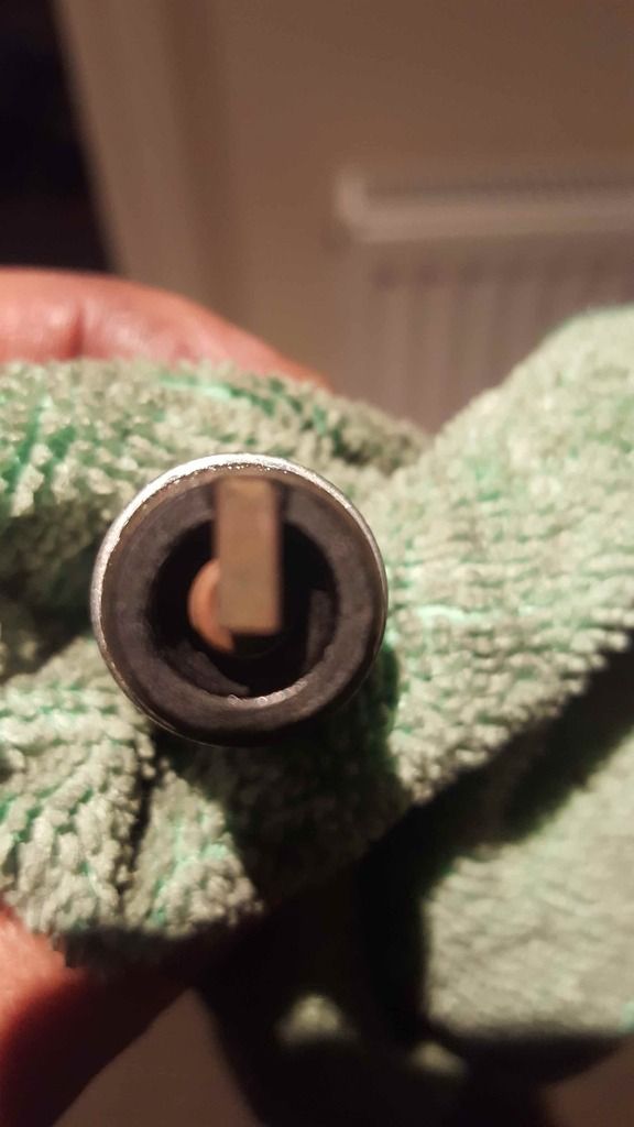

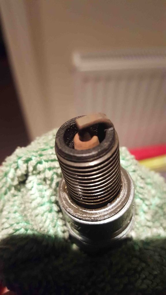

Postby Simon_T » Tue Aug 09, 2016 9:47 pm
LATEST IS IVE PUT THE 268 ATOMISER BACK IN NEEDLE IS TOP CLIP AND LOOKING COCOA COLOUR WILL TRY UPLOAD PICS IF I CAN REMBER HOW.
Simon_T
Posts: 105
Joined: Thu May 29, 2014 11:17 pm
Location: Sutton Coldfield
Re: phbh 28mm and muggy 198
Postby Simon_T » Tue Aug 09, 2016 9:55 pm
[img][IMG]http://i1383.photobucket.com/albums/ah306/simon_taylor9/PLUG1_zpswwsq0mji.jpg[/img][/img]
[url][URL=http://s1383.photobucket.com/user/simon_taylor9/media/PLUG1_zpswwsq0mji.jpg.html]Image[/url][/url]
[url][URL=http://s1383.photobucket.com/user/simon_taylor9/media/PLUG3_zpszpy6ql9w.jpg.html]Image[/url][/url]

Postby Rich Oswald » Wed Aug 10, 2016 10:54 am
Still looks weak to me!

Postby Simon_T » Wed Aug 10, 2016 5:46 pm
Rich Oswald wrote:Still looks weak to me!
Any suggestions Rich please.
change needle to x13 ?
change slide to 40 ?
put 55 pilot back in ?
much appreciated.

Postby Rich Oswald » Thu Aug 11, 2016 9:37 am
much appreciated.
That all depends on what throttle position those pics were at. Different adjustments are needed depending on that.

Postby corrado » Thu Aug 25, 2016 12:10 am
Ideally you'd need to do plug checks at 4 settings minimum, 1/4, 1/2, 3/4 and full throttle. Stick a bit of masking tape on your switch housing and wrap some masking tape around the throttle grip adjacent to the bit on the switch housing. Put a mark on the switch housing and a mark on the throttle grip with throttle off, then turn throttle to wide open and put a mark for full throttle, from there it's easy to work out the marking for 1/4, 1/2 and 3/4 settings. The idea of a plug check is to be able to take a [virtual] photograph of the plug at an exact point in time. You need to ride at set throttle position for at least 1/2 mile and to get your virtual photograph you need to switch off the ignition [or hit the kill switch] and immediately pull in the throttle and coast to a halt [don't pull in clutch before switching off engine or revs will rise]. Ideally find somewhere with lay-byes that you can coast into. Then remove plug and check colour, worth doing it a few times at each setting to be certain you've given it enough time to build up plug colour. Doing a few checks at each throttle position might take a couple of hours but that's time well spent if it saves you a holed piston down the line.
