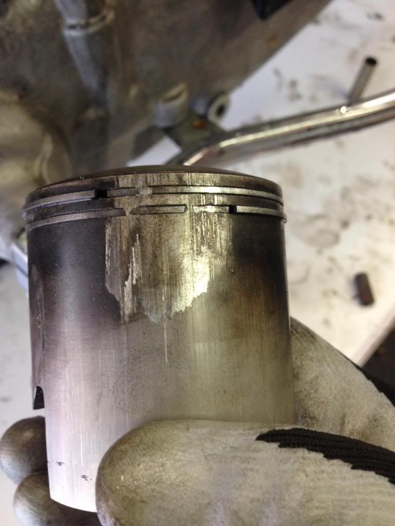

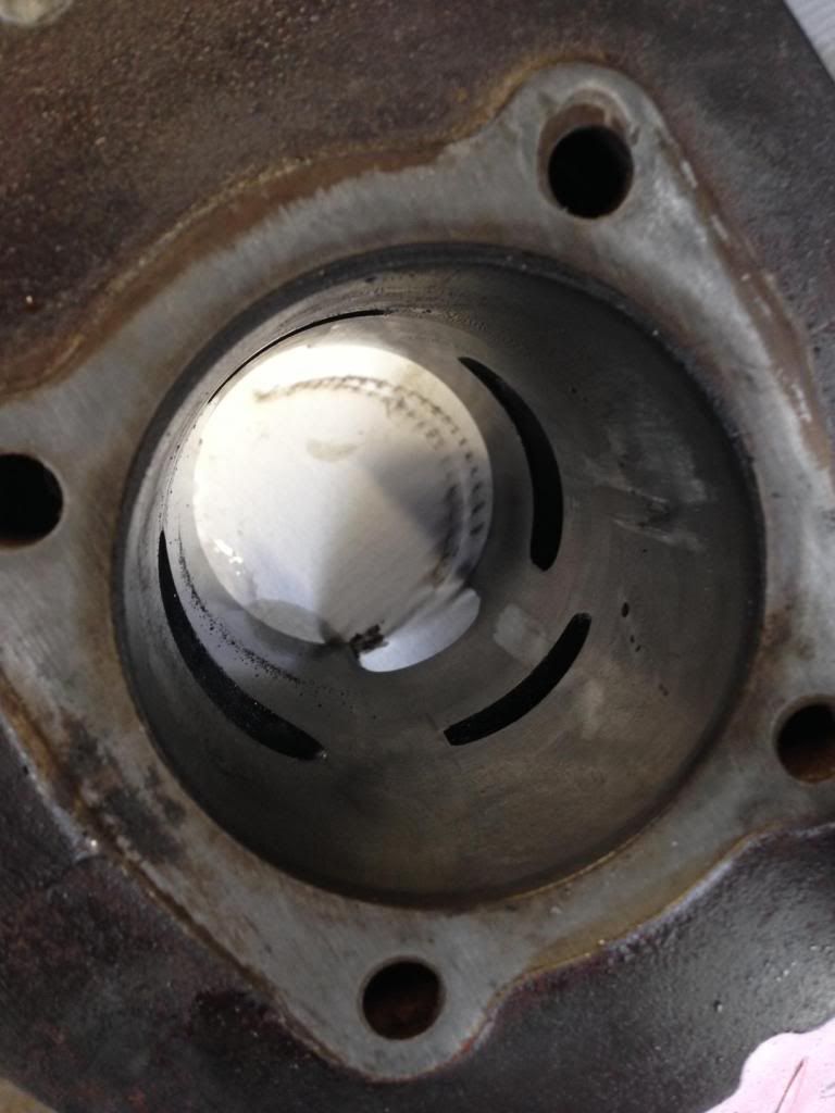

Your piston is fecked :) but the barrel looks OK,a rebore and will be fine.
Good luck with all the other projects ;)
