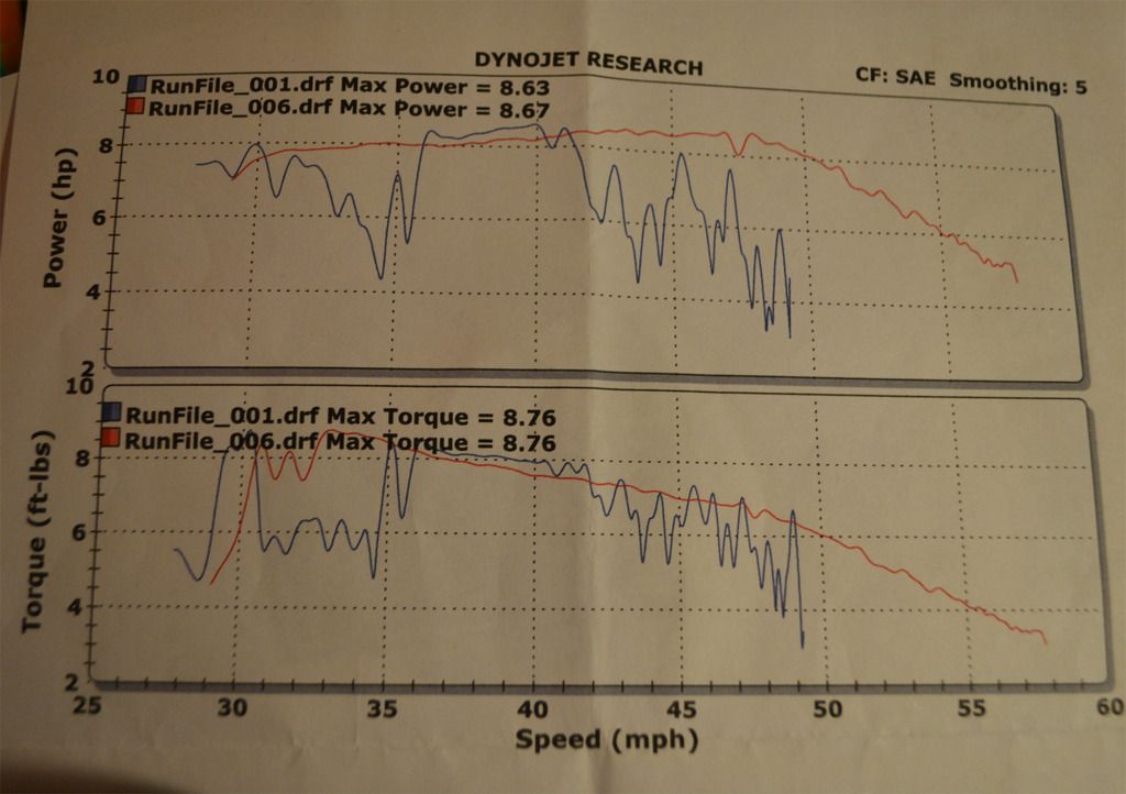

Postby Andie » Tue Oct 04, 2016 3:43 pm
Just to update, I had the stator strobed and the scoot dynoed and jetted at Chiselspeed last Friday, a respectable 8.5 bhp, which is not bad at all.
All good now - Andrew
Andie
Posts: 216
Location: Leeds
Re: setting casatronic ignition with strobe
Postby johnnyXS » Tue Oct 04, 2016 4:52 pm
thats great news Andie but what did they actually do ?
If we don't know what they did then there is no answer or conclusion to this thread and no potential help for others that arrive here .
johnnyXS
Postby Phil D » Tue Oct 04, 2016 9:02 pm
+ 1 The suspense is killing me ! :P
Phil D
Posts: 972
Postby Andie » Tue Oct 04, 2016 9:03 pm
Hello.
The stator was set and strobbed as it had slipped a few degrees and was well off.
I hadn't fitted the second earth as I thought the stator earthed; it does but an extra earth was fitted from the CDi unit to the flywheel cowling.
Plug was changed from a 7ES to an 8ES
Then some dyno & jetting.
I'd been running very lean as I have fitted a fast through mesh air-filter and a drilled out late S3 air box, I probably only need one of these things on an iron 175, if any...
jetting was quite severe!
blue before dyno, red after
I was also advised to tighten the u-bend (which I did) - I cannot get to the AFC exhaust bolts without removing the cowl so as to facilitate using a spanner (due to the u-bend curving over the bolts so socket access is impossible on LHS) so I am thinking of changing the U-bend and cutting the cowl for access.
The change is immense, outcome is I should have had it set-up long ago, as I often don't know as much as I think I do ;)

thats excellent Andie. I don't suppose you made a note of which atomiser and main jet they fitted did you ? ;)
A 2x degree change in timing is huge and on its own would make a big difference to power and performance.
Thanks for posting ;)
