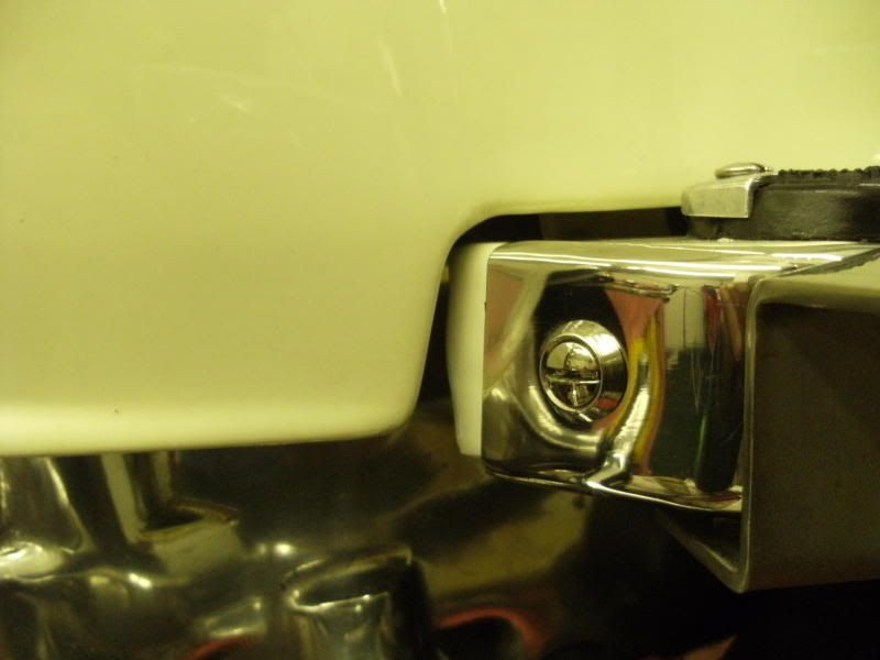

Postby peejay » Wed Feb 18, 2015 12:45 pm
Markpm wrote:TSR looks like a shout
Thanks for replys ;)
hi Mark
i bought this type (but not from TSR), where the stud is welded on there will be a very small dimple, you cant prevent that during the welding process but it hardly notices.
personally i think that with the studs welded on it causes loads of grief when fitting. i removed the studs and most of the weld with a dremel then drilled 6mm holes and used 5mm bolts to give me a bit of leeway to make things easier to fit.
